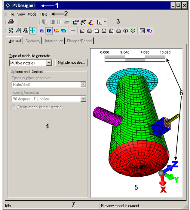

Figure 1: PVDesigner Interface
  1. Title Bar: The Windows standard title bar displays the program name and the model name.
  2. Menu Bar: The menu bar is located just below the title bar and contains the pull-down menus.
  3. Toolbars: The dockable toolbars provide you with quick access to many PVDesigner commands. Use the View Toolbars command to choose which toolbars to display.
  4. Input Area: The input area is where you enters the dimension of the various segments of the vessel. Some input is also entered in pop-up dialog windows.
  5. Preview Area: The Preview Area shows the model as it is being built.
  6. Miniaxis and Scale Ruler: The miniaxis shows your viewpoint with respect to the three dimensional working area and the scale ruler shows the relative size of the model. Use the Model Preferences MiniAxes/Dimension Scale command to control the visibility of these items.
  7. Status Bar: The status bar displays important messages about the model. For example, attempting to place a 5 foot diameter nozzle on a 3 foot diameter vessel will generate a warning about the sizes. Keep an eye on the status bar.

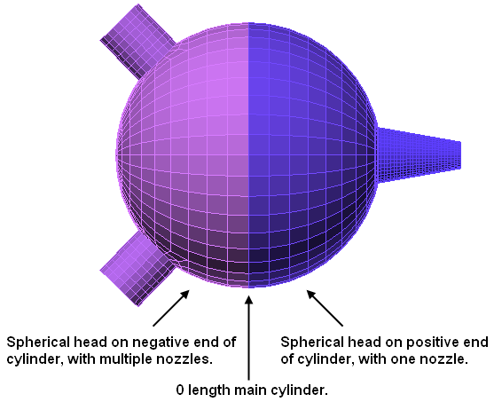

In many cases, complex vessels can be created with a single PVDesigner model by using a combination of the main cylinder, nozzles, heads, and nozzles on the heads. In other cases, multiple models can be created with PVDesigner and merged together in Autodesk Simulation. (Create each model separately, then use Merge.) Examples are shown in Figures 2 and 3.
Figure 2: Spherical Vessel with Multiple Nozzles
Figure 3: Example PVDesigner Vessel with Multiple Nozzles and Heads
