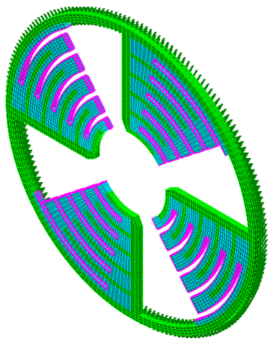

For your convenience, all of the lines belonging to the rotor contact surfaces of the air have already been assigned a common surface number, specifically surface 5. This facilitates the Coulomb force calculation setup, since only one surface must be specified.
We will now visually verify the Coulomb force calculation surface and then set up the force calculation.
  1. Click the  Home icon above the ViewCube for an isometric view of the model.
  2. Right-click the Part 2 heading in the browser and deactivate the Visibility option. Press <Esc> to clear the selection from the display area. The rotor will no longer be visible.
  3. Expand the list of surfaces under Part 3 by clicking the "+" sign to the left of the Surfaces heading.
    • Select Surface 5 < Unnamed >. All of the rotor contact surfaces for the air (Part 3) are magenta, indicating that they have been selected, as shown below.
