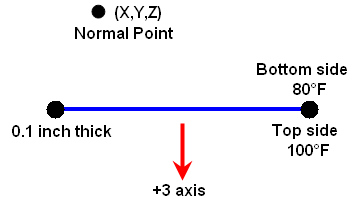

  • Normal Point (X), Normal Point (Y), and Normal Point (Z). A point in space is used to control the orientation of the element's normal axis (+3 axis), or which side of the element is the top side (+3 side) and the bottom side (-3 side). The normal direction is determined by specifying a point in space using the Normal Point (X), Normal Point (Y), and Normal Point (Z) columns. See Figure 2. A positive normal pressure is applied normal to the plate elements in the direction of the +3 axis and points away from the element normal point.
    Tip: The normal point does not need to be over the element as implied by Figure 2. Mathematically, the side of the plate element that faces the element normal coordinate is the bottom of the element.

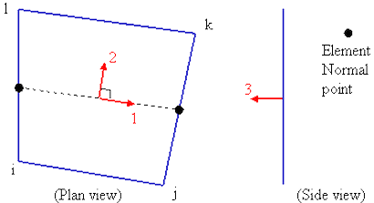

  • Nodal Order Method. For a general FEA analysis, you can ignore the element's in-plane orientation (axis 1 and 2). The ability to orient elements is useful for elements with orthotropic material models and for easily interpreting stresses in local element coordinate systems. Which method is used to control the in-plane orientation is done with the Nodal Order Method drop-down menu. If the Default option is selected, the edge of an element with the highest surface number is chosen as the ij side. If the Orient I Node option is selected, the node on an element that is closest to the Nodal Point (see next item) is designated as the i node. The j node is the next node on the element following the right-hand rule about the element's normal axis (+3 axis). If the Orient IJ Side option is selected, the side of an element that is closest to the Nodal Point is designated as the ij side. The i and j nodes are assigned so that the j node can be reached by following the right-hand rule about the element's normal axis (+3 axis) along the element from the i node. Once the i and j nodes and axis 3 are defined, the element's local 1 and 2 axes are determined. See Figure 3.
    Figure 3: Local 1 and 2 axes for Plate Elements
    The dots along the side of the element are at the midpoint of the side.
  • Nodal Point (X), Nodal Point (Y), and Nodal Point (Z). If the Nodal Order Method for in-plane orientation is set to Orient I Node or Orient IJ Side, then use these three columns to enter a coordinate to define the element's in-plane orientation (see previous item).
  • delta T thru thickness. Regardless of the method selected in the Temperature Method drop-down menu, you can specify the temperature gradient in local 3 direction in the delta T thru thickness column. This is equal to the change in temperature across the plate divided by its thickness: delta T thru thickness = (Ttop-Tbottom)/thickness. See Figure 4. A temperature gradient causes the plate to bend but not to grow or shrink.
    Figure 4: Temperature Gradient Through a Plate Element
    ΔT Gradient Through the Thickness:
    = (T top - T bottom) / thickness
    = (100 - 80 °F) / (0.1 inch)
    = 200 °F/ inch
