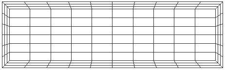

Inlet
With the default boundary layer mesh, a thin layer of elements is created at the surfaces of the part. But the thin layer of elements at an inlet or outlet can cause solution difficulties.
Outlet

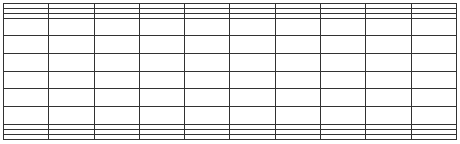

Inlet
The boundary layer mesh is excluded at the inlet and outlet faces. The analysis converges better.
Outlet
