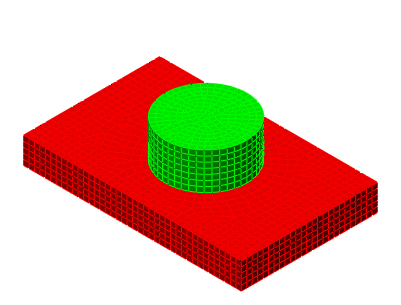

By including the circular part in the CAD solid model and importing this assembly into Simulation Mechanical, the circular pattern of nodes needed for the boundary conditions is automatically created. The default virtual imprinting feature of the mesh engine ensures that the meshes match between the two parts.
However, there is still only one surface atop the rectangular part. In addition, when the circular part is suppressed in the FEA model, there is no circular edge to select for convenient application of the desired constraint.

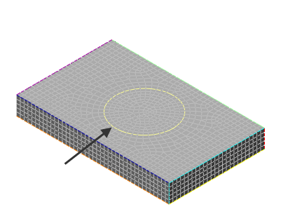

Finally, by enabling the Split surfaces on import option before importing the two-part CAD assembly, the rectangular face will be split into two surfaces—a rectangle with a hole in it, and a circular surface. In addition, a new edge will be added to the rectangular part (corresponding to the perimeter of the round part, shown in yellow). This circular edge makes it very easy to apply the desired boundary condition to the rectangular part.
If a pressure were to be applied instead of a boundary condition, the circular area could also be selected (when surface splitting has been performed).
