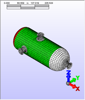

Now we will look at the preview of the model in PV/Designer and then generate the model and view it in the FEA Editor environment.
- Click the
middle
mouse button in the display area and drag the mouse to rotate the viewpoint of the model. Inspect the structured mesh of the pressure vessel.
- Click
View
Orientation
Isometric to return to the isometric view. The model displays as shown in the following image.

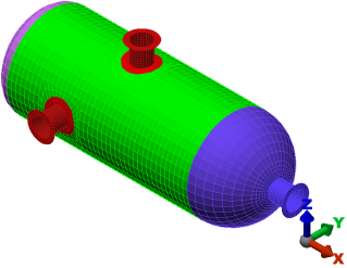

- Click File
Done to exit PV/Designer and open the model in the FEA Editor environment. The model displays as shown in the following image.
Many options are available for the shape of the heads, offsetting the position and angle of nozzles, placing heads on nozzles, making the nozzles tapered, and more. For this tutorial, we used automatic mesh divisions. Manual mesh customizations are also possible. Finally, PV/Designer can output plate/shell or solid geometry.
Note: Once the model has been transferred to the FEA Editor environment, you can return to PV/Designer to modify the geometry or mesh by clicking
Tools
Edit
Pressure Vessel.
