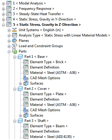

One FEA model (one .FEM file) can contain numerous analyses or Design Scenarios: the results of each scenario are saved in a separate folder under the main model folder. For example, one model could contain all these analyses:
The tree view for the above design scenarios is shown in the following image (scenario 5 is active).
When working with a CAD Solid Model, each Design Scenario uses the same CAD geometry, but all other parameters (mesh size, loads, constraints, manually added elements, and so on) can be changed from one scenario to another.
