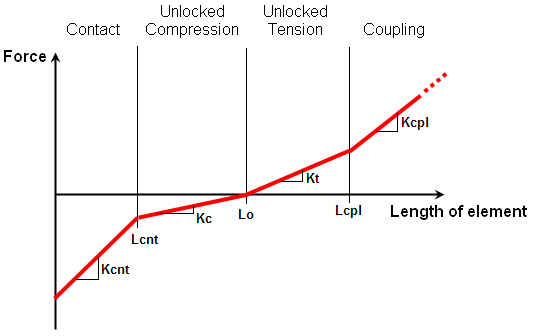

In all cases (unlocked, contact, and coupling), the stiffness of the element will be the product of the modulus (E) and cross-sectional area (A) divided by the length (L), or stiffness = A*E/L. The length L depends on the length of the element as drawn in the model and the input lengths of contact distance and coupling length. Refer to the following figure and table.
Figure 1: Stiffness of General Contact Element
where
  • Lcnt is Contact Distance
  • Lo is the length of the element as drawn in the model. Note that each element with a different length will have a different stiffness.
  • Lcpl is Coupling Length
  • Kcnt is the stiffness of the element when in the Contact region. The length is less than Lcnt.
  • Kc is the stiffness of the element when in the Unlocked Compression region. The length is between Lo and Lcnt.
  • Kt is the stiffness of the element when in the Unlocked Tension region. The length is between Lo and Lcpl.
  • Kcpl is the stiffness of the element when in the Coupling region. The length is greater than Lcpl.
    Initial Element Length, Lo
  Lo < Lcnt Lcnt < Lo < Lcpl Lo > Lcpl
Stiffness, K
Kcnt = A*Ec/Lcnt + A*Ecnt/Lcnt
no unlocked compression
Kt = A*Et/Lcnt
Kcpl = Kt + A*Ecpl/Lcpl
Kcnt = Kc + A*Ecnt/Lcnt
Kc = A*Ec/Lo
Kt = A*Et/Lo
Kc = A*Ec/Lo
no unlocked tension
Kcpl (for L>Lo) = A*Et/Lo + A*Ecpl/Lcpl
Kcpl (for L<Lo) = A*Ec/Lo + A*Ecpl/Lcpl
Initial Force, Fo Fo = 0 Fo = 0 Fo = Kcpl*(Lo-Lcpl)
where Ecnt, Ec, Et, and Ecpl are moduli for contact, unlocked compression, unlocked tension, and coupling, respectively.
