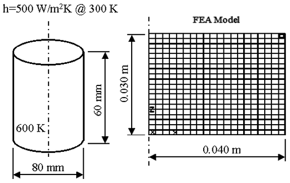

Given: A stainless steel cylinder (AISI 304) initially at 600 K is quenched by submersion in an oil bath maintained at 300 K with a convection of h = 500 W/m 2 K. The length of the cylinder is 60 mm and the diameter is 80 mm. Material properties for stainless steel (AISI 304), taken from Introduction to Heat Transfer, are: density = 7900 kg/m 3 , conduction coefficient = 17.4 W/m K, and specific heat = 526 J/kg K.
Find: What are the temperatures at the center of the cylinder, at the center of a circular face, and at the midheight of the side at 3 minutes into the cooling process?
Figure 1: Problem Geometry

For an axisymmetric model, only the cross-section from the center line of the cylinder to the outside is modeled. Due to vertical symmetry, only the top half of the cross-section is modeled. The model must be located in the YZ plane with the Z axis the centerline.
