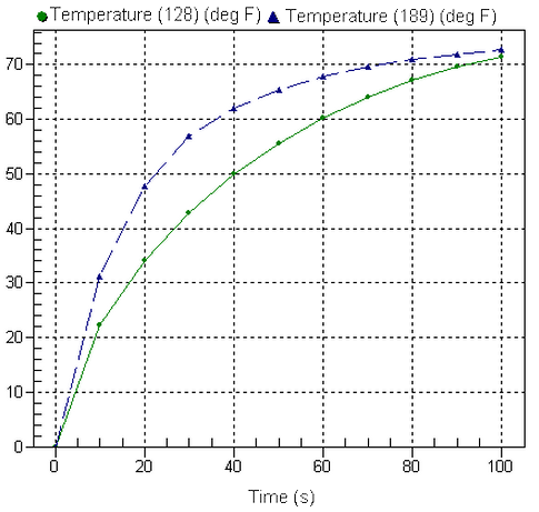

Graphs of results at selected nodes can be created. For static analyses, a bar graph is created comparing the result at a node versus the different load cases. For time-dependent analysis, a line graph is created that will track the result at a node throughout the duration of the analysis. (See Figure 1) By default, time or load case is the value on the horizontal axis.
Figure 1: Example Graph of a Result Versus Time
The temperature at two nodes from a transient heat transfer analysis is graphed.

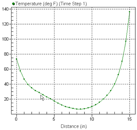

Also, the result along a line or path of nodes through the model can be graphed. (See Figure 2) For example, the temperature through the thickness of refractory wall can be graphed. Distance between the selected nodes is the value on the horizontal axis.
Figure 2: Example Graph of a Result Along a Path
Temperature along the edge of a model is graphed. The path plot is for one instant in time (time step 1 in this example).

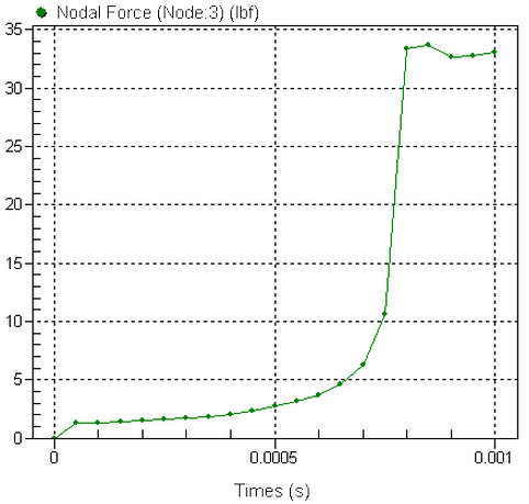

The applied loads in the model can also be graphed versus time or load case. This is particularly useful for results based loads in which the user-applied load is a calculation based on the results. (See Figure 3) (Note: Some loads in static stress will not graph as expected. This is because some loads, such as nodal forces, are applied to only one load case; different load cases may have nodal forces applied to the same node, but the item selected is different.)
Figure 3: Example Graph of Applied Load Versus Time
The force of two magnets increase as the supporting structure deflects towards each other. Contact between the magnets occurs at 0.0008 seconds.

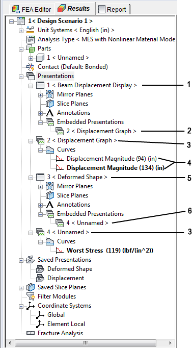

Also a heading in the tree view will appear for the new graph under the Presentations heading. See Figure 4.
Tip: Keep in mind that a graph is simply another window in the Results environment. As such, it can be tiled (using the Window menu) and resized just like any other window. To delete the graph presentation window, click the X or use the Window: Close menu command.
Figure 4: Tree View With Contour and Graph Presentations
Legend:
  1. Presentation (contour display)
  2. Embedded graph (from presentation #2)
  3. Presentation (graph)
  4. Two curves in one graph (bold one is active)
  5. Presentation (contour display)
  6. Embedded graph (not another presentation)
Note: Each Presentation is a separate window containing either a contour display or a graph.

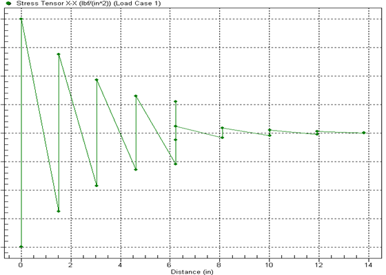

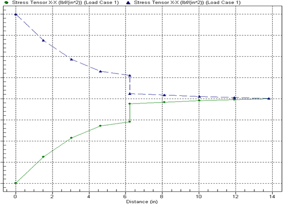

  • Scatter plots: The path plots are graphs of results at the nodes. Some results actually are output at the corners of the elements: these are referred to as element results. The settings for the smoothing determine whether one result is given at the node or whether multiple results are shown at the node. (See the paragraph Understanding the Results on the page Results: Results Environment for a detailed discussion.) When plotting these element results, the path plot will be shown as a scatter of data points not connected together if any of the nodes have multiple results.
    Tip: After any graph is created, the method used to show the data points can be changed by right-clicking on the graph and choosing the Plotting Method command. For example, Plotting Method: Points + Lines will connect the points together. Depending on the settings for the path plot, the connected points may or may not be in the appropriate order.

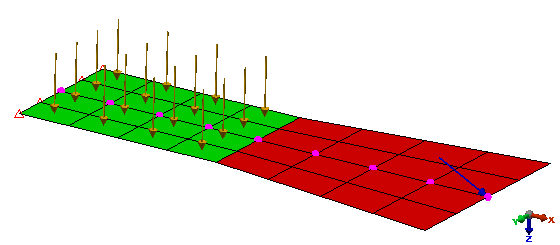

For example, take the two-part plate model shown in Figure 6a. The nodes along the centerline are selected for the path plot. If the result being displayed is the X-X stress tensor, then with the default settings each node has two different values (the stress on the top and bottom of the plate), and the node at the junction between the parts has 4 different values (two values for the top and bottom of part 1 {green part}, and two values for the top and bottom of part 2 {red part}). The path plot is shown in Figure 6b. Instead of trying to plot the top and bottom stresses simultaneously, set Results Contours Settings Plate/Shell Options to top side only, make a path plot. Go back to the stress contour window, set the Plate Options to bottom side only, and add the path plot to the existing graph. This creates two curves on one plot, so the data points follow a natural connection. See Figure 6c.
(a) A two part plate model. The nodes on the centerline are selected for creating a path plot.
(b) Since plate elements have different stresses on the top and bottom, creating a plot of the X-X stress tensors with the default settings produces one scatter plot. When the Plotting Method: Points + Lines is used, it can be seen that the data is not connected in the expected manner.
(c) When two separate plots are created, one with the X-X stress for the top side of the plates and one with the X-X stress for the bottom side of the plates, the data points make sense when connected with lines.
Figure 6: Example Path Plots of Element Results
