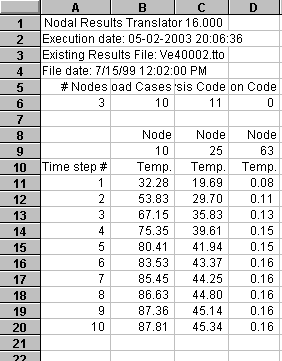

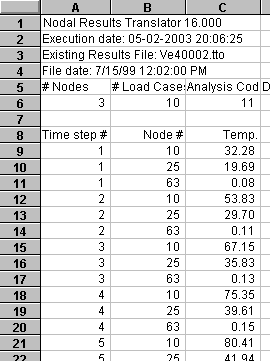

The difference between grouped results and ungrouped results can be seen in the following example.
| ''Group results'' unchecked. The selected results (temperature from a transient heat transfer analysis in this sample) are written one node per line, placing all results in one column. (The Nodal Results Translator output shown imported into a spreadsheet.) | ''Group results'' checked. The same set of results is written one time step/load case per line, placing all results in multiple columns. This format is easier to plot and do other manipulations, such as the average result over time. |

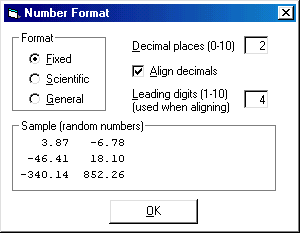

The format of the output numbers (only the six degree of freedom numbers) can be controlled by clicking this button. Doing so will give the following pop-up window:
Specify the format of the text output with the Number Format dialog box. A sample, based on randomly generated numbers, is shown as each option is changed.
