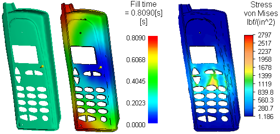

Autodesk Simulation Moldflow provides easy-to-use tools that simulates the injection molding process, which allows the user to optimize the part, mold, and tool designs long before manufacturing begins. By using a digital prototype to simulate the injection molding process, you can reduce the number of physical prototypes required to perfect a design and get your products to market faster.
Because injection molding can result in materials that are anisotropic in nature (different properties in different directions) and with varying orientation of the fibers throughout the part, performing a Moldflow analysis and incorporating the results in the Simulation Mechanical stress analysis will provide a more accurate simulation.
