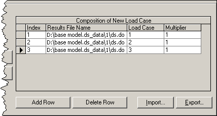

Since the new results can contain multiple load cases, the left half of the Specification of New Load Cases section  is used to create and display the new load cases. The Load case in combined model pull-down is used to set which new load case is being shown in the Composition of New Load Case spreadsheet. New load cases are added to the new results by clicking the Add new load case button. In the previous example, you click the Add new load case button 9 times to get the 10 load cases required. The Composition of New Load Case spreadsheet needs to be filled out before adding a new load case.
Figure 1: Load Cases to Create (continued in Figure 2)

Specify Models to Combine
The right half of the Specification of New Load Cases section is used to indicate which previously analyzed models to combine, which load case to use from the models, and the multiplier used for each load case. Use the Add Row and Delete Row buttons to add or delete rows to the spreadsheet to specify additional model results to combine.
Figure 2: Models to Combine(continued from Figure 1)
Clicking in the Results File Name or Load Case cell of the spreadsheet will give a new dialog window. Use the Select Results File button on the new dialog to indicate which results file to use in the combination. Be sure to set the Files of type: drop-down arrow as necessary for the type of results to select. (Also, keep in mind that the results are located in the design scenario folder under the model's ds_data folder.) After the file is chosen, use the Existing load cases in file pull-down on the new dialog window to indicate which load case to use from the analyzed model. Click the OK button to fill the information into the spreadsheet.
Note: For some analysis types, such as Frequency Response, the load case number shown in the Results environment is not the same as the load case number in the results file. For Frequency Response, the results file in has load cases 1 through n, whereas the Results environment shows load cases 1 through i for the in-phase component, 1 through i for the out-of-phase component, and the resultant. (n = i + i + 1 in this example.)
Click in the Multiplier column of the spreadsheet to enter the multiplier for the chosen load case. The multiplier can be any value: positive or negative, whole number or fraction.
