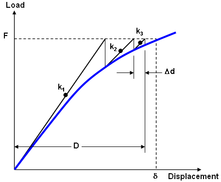

The convergence of the solution can be based on two results, displacement and energy. Energy is a product of the displacement and force tolerances. This must be selected in the Convergence criteria drop-down box. The convergence will be compared to the values specified in the Displacement tolerance and Force tolerance fields. (See Figure 1.) The displacement tolerance can either be entered by the user or set by the processor based on other settings in the model when Automatic check box is activated. (0.005 with contact and 0.0001 without contact.)
Figure 1: Convergence Tolerance
The blue curve shows the theoretical stiffness (Load/Displacement) of a model. The displacement δ for an input force F is appropriate. In a nonlinear analysis, a number of iterations calculate the stiffness along the curve (k1, k2, k3,). The solution is considered to be converged when the displacement in the last iteration (Δd) compared to the overall displacement D is less than the convergence tolerance (Δd/D < tolerance).

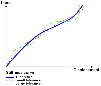

Analyses with large dynamic effects need a smaller tolerance. (Highly dynamic analyses may also require time steps small enough to capture the wave propagation through an element, proportional to the square root of stiffness/mass.) Analyses with simple loading can use a larger tolerance if 10% to 20% accuracy is sufficient. See Figure 2. As with all FEA, multiple runs with different tolerances may be required to determine the effect of the tolerance size.
Figure 2: Schematic of Effect of Tolerance Size on Solution
