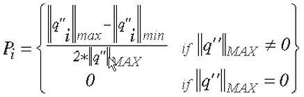

Precision
Precision is a method of highlighting stepped changes in results from one element to the next. In an ideal model, the current flux would change smoothly between adjacent element. In the process of discretizing the model with elements, there will always be some change in results from one element to the next. The results are not continuous.
In Electrostatic, the precision is based on the discontinuous current flux magnitude (or electric field) from element to element (across element boundaries). It is calculated as follows:
where:
P i is the precision at node i,
max is the maximum current flux (or electric field) magnitude at node i obtained by finding the maximum over its neighboring elements,
min is the minimum current flux (or electric field) magnitude at node i obtained by finding the minimum over its neighboring elements,
MAX is the global maximum of the current flux (or electric field) magnitude.
Based on the formula, the range of precision values is 0 to 0.5, inclusive.
