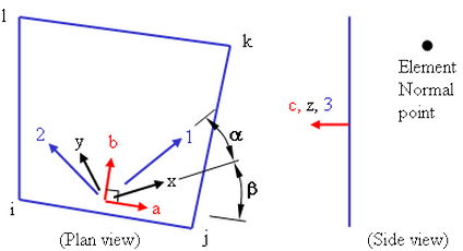

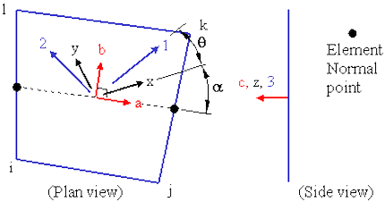

Use Element-Local Results
This command will only be available for stress analyses. If this command is active, the stress and strain tensors will be displayed in element local coordinates when you select the Results Contours Stress Tensor or Results contours Strain Tensor, respectively.
When displaying results in element local coordinates, the legend will display 1 for the X direction, 2 for the Y direction, and 3 for the Z direction. For example, choosing Results: Stress: Stress Tensor: XY will display the shear stress in the local 1-2 coordinate system.

Figure 4: Element Local Results for Linear Composite Elements are in the 1-2-3 direction.
The element local axes (a-b-c) are based on the i-j-k-l sides. The Laminate or Material axes (x-y-z) are rotated α degrees from the element axes (a-b-c). (The material axes are set in the Element Definition on the General tab.) The Lamina axes (1-2-3) are rotated ϑ degrees from the Laminate axes. Axis 1 is parallel to the fibers for each lamina. (The lamina axis is set in the Element Definition on the Laminate tab using the Orientation Angle.)
Figure 5: Element Local Results for Nonlinear Elements
2D, Membrane, and Shell (except for Composite) The local 1 axis is parallel to the i-j side.
Figure 6: Element Local Results for Nonlinear Composite Elements are in the 1-2-3 direction.
The element local axis a is parallel to the i-j side. The Laminate or Material axes (x-y-z) are rotated b degrees from the element axes (a-b-c). (The material axes are set in the Element Definition on the General tab.) The Lamina axes (1-2-3) are rotated a degrees from the Laminate axes. Axis 1 is parallel to the fibers for each lamina. (The lamina axis is set in the Element Definition on the Composite tab using the Orientation Angle.)
Note: When the Point method is used to orient the material axis in nonlinear elements, the processor calculates a unique direction for each gauss point in each element. The Results environment calculates one direction for each element (based on the user-defined point and the centroid of the element) and transforms the results from global to local. Thus, the local results may not be aligned exactly with the materials (or fibers in the case of composite elements) depending on the proximity of the element to the user-defined point.
