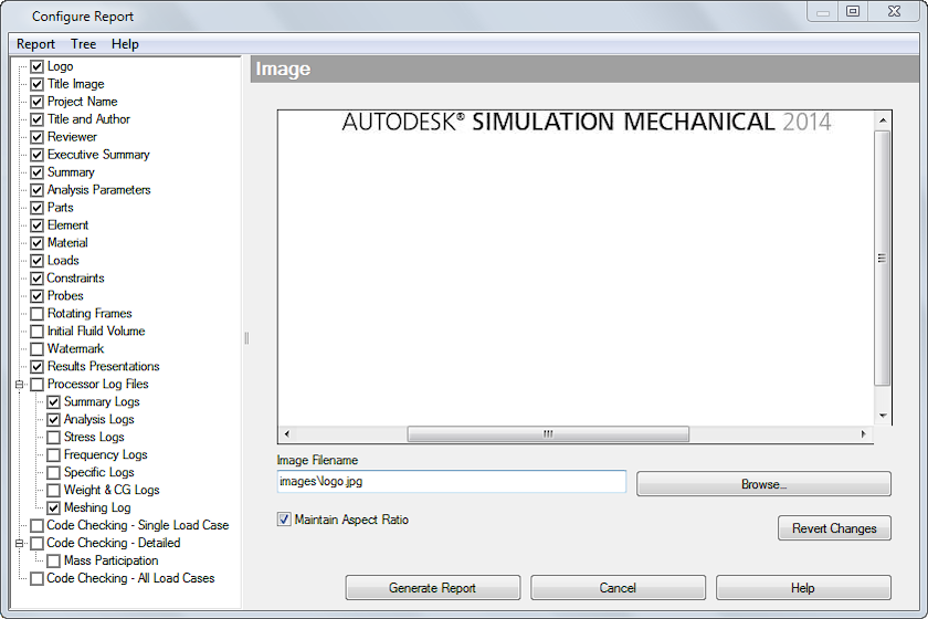

Both the Master report and the individual design scenario reports are customized in a similar fashion. View the report to change, and then use Report Setup Configure. This accesses the Configure Report dialog. (See Figure 1)
Figure 1: The Configure Report Dialog Box

Choose Sections To Include in the Report: Each section of the report is listed in the browser (region 1 in Figure 1). Activate or deactivate the check box to include or remove the section from the report.
Customize Each Section: When a report section is chosen in the browser, the customization options are shown in the display area (region 2 in Figure 1). For example, image sections let you browse for a new image and stretch the size of the image. Text sections display a text editor where you can enter custom text, change the font, color, and other attributes. Message sections are created automatically based on the model's input and cannot be changed in the Configure Report dialog, but they can be re-ordered. (The message sections can be customized by using a custom CSS file. See the next page, Customize Reports, for details.)
Re-Order the Sections: Each section of the report can be moved to a new location in the browser. Use the left mouse button to drag the highlighted item to a new location.
Add New Sections: To add a new section to the report, right-click in the browser and choose one of the following types:
