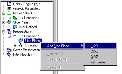

Slice Planes
Use the available slice plane commands to create, activate, deactivate, or manipulate the visibility, position, and orientation of slice planes. In order slice plane editing commands to be active, you must have an active slice plane in the current presentation window.
You can use the ribbon commands or a context menu to create a slice plane. For the latter method, right-click the Slice Planes heading in the Presentation section of the browser, as shown in the image below. Select the Add Slice Plane command and then select one of the options in the next pull-out menu.
Once a slice plane is selected, it will appear on the model and the commands under Slice Planes in the ribbon will become active. A sample slice plane is shown below. The descriptions of the commands will refer to this image.
