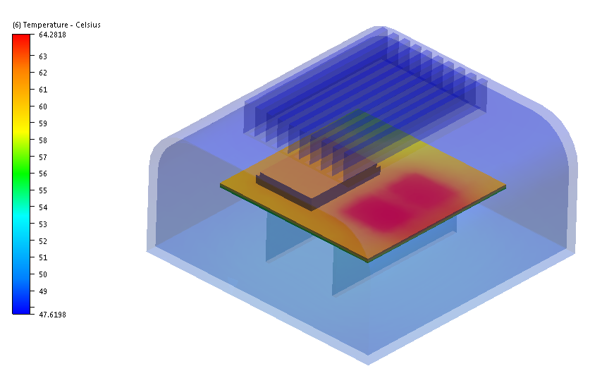

Example
An application of this interoperability is to compute the thermal stress in components within an electronic enclosure. Using Simulation CFD, we assign thermal dissipations to several components and simulate the air flow and heat transfer. The result is a temperature distribution on every component in the model.
We load the same CAD model into Simulation Mechanical, assign materials and constraints as needed, and select the CFD design study file. When we start the analysis, Simulation Mechanical uses the temperature results as loads, and computes the thermally-induced stress on the components. The result is a view into the system performance that includes the flow and thermal behavior within the enclosure as well as the structural behavior of each component.

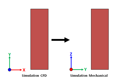

- 2D Modeling:
- Simulation CFD solves 2D models in the XY plane. Simulation Mechanical solves 2D models in the YZ plane.
- Before launching the model into Simulation Mechanical, you should re-orient the model in your CAD system from the XY plane to the YZ plane. The model X direction should point in the global Y direction, and the model Y direction should point in the global Z direction.
- Because only the Z axis can be used as the axis of symmetry for axisymmetric models in Simulation Mechanical, ensure that the CFD model uses the Y axis as the axis symmetry. An error is issued if the CFD model is axisymmetric about the X axis. (As with all 2D models, re-orient the model to the YZ plane using the mappings shown above prior to launching into Simulation Mechanical.)
- To reorient a 2D model in Inventor, right click on the sketch in the browser window, and click Redefine. Select the new plane (YZ Plane) from the list of planes below the Origin branch. This automatically re-orients the model according to the direction mapping described above.
