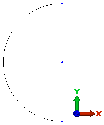

  3. Click View Navigate Enclose (Fit All). The arc should appear as shown below.
    Note: This arc orientation is necessary if we are to mirror the resulting half-structure about the YZ plane. The structure we are building is shown in the half-model image below (with the arc just created highlighted). Note that the structure is symmetrical about the YZ plane.

The model should display as shown in the following image.
