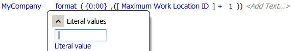

    For example, you might add a prefix and/or suffix to the default name. Enter the prefix or suffix as a Literal Value. You can use the FunctionFormat to create a default work location name such as MyCompany01, MyCompany02. The rule would be:
    MyCompany format ({0:00}, ([Maxiumum Work Location ID] + 1))
    Note: If any empty spaces are created as you define the rule, be sure to delete them.
