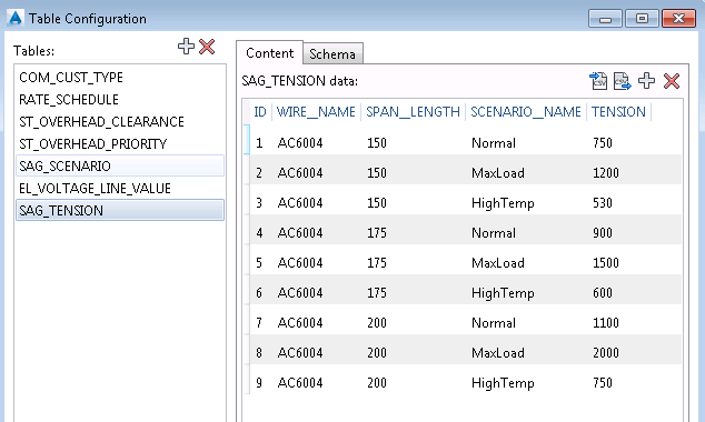

  1. Click Configuration tab Setup panel Table Editor and create a table similar to the following with your sag tension data.

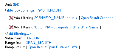

  3. In the Rule Configuration editor, click AnalysisSagEquationTension.
  4. Click Create Rule.
  5. Using the Table Lookup Range function, define a rule similar to the following:
