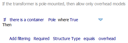

Sizing rules control the selection of appropriate models for features. This sample transformer sizing rule specifies that for pole-mounted transformers, only overhead models are allowed.

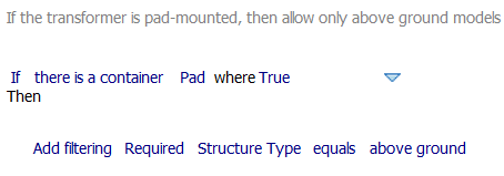

This sample transformer sizing rule specified that for pad-mounted transformers, only above ground models are allowed.

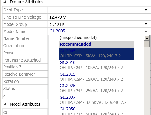

As a result of these sizing rules, only appropriate transformer models are shown in the Recommended group for the model attribute.
