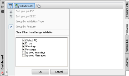

  • Validation Results—As you create features, validation rules check for issues and display them in the Validation Results palette. Use the Filter option to specify which issues are displayed and how the information is organized. For more information, see About Design Validation.

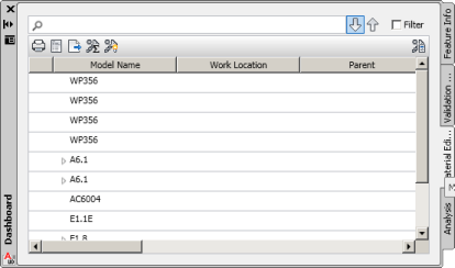

  • Material Editor—As you create features, the Material Editor generates a dynamic material list. For more information, see About Material Lists.

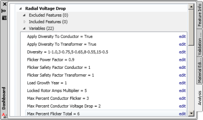

  • Analysis—Displays the available analysis operations, the features included and excluded from each operation, variables and rules that define the analysis, and results after the analysis is complete. For more information, see About Analysis Results.
