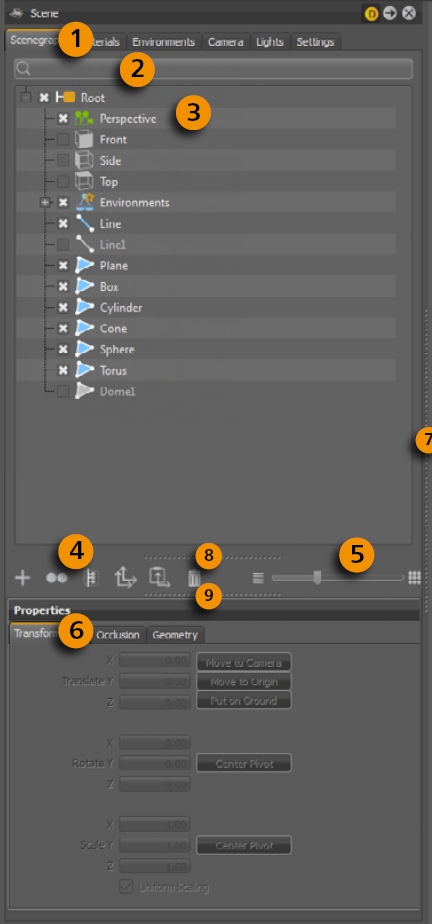

The Simple UI includes the Scene module, which contains all scene elements, like geometry, materials, environments, cameras, lights, and render settings on different tabs at the top of the window.
1 Tabs
2 Search field
3 Scene tree
4 Properties element with tabs
5 Scene module slider
6 Properties element with tabs
7 Width adjustment
8 Second scene tree (meta tags)
9 Window splitting adjustment
Use the vertical dotted line (7) to resize window width. Use the dotted line over the Properties window (9) to resize the windows splitting size. Use a second dotted line over the icons bar and slider (8) to open a second scenegraph. These features are helpful for arranging scene objects within large scene trees.

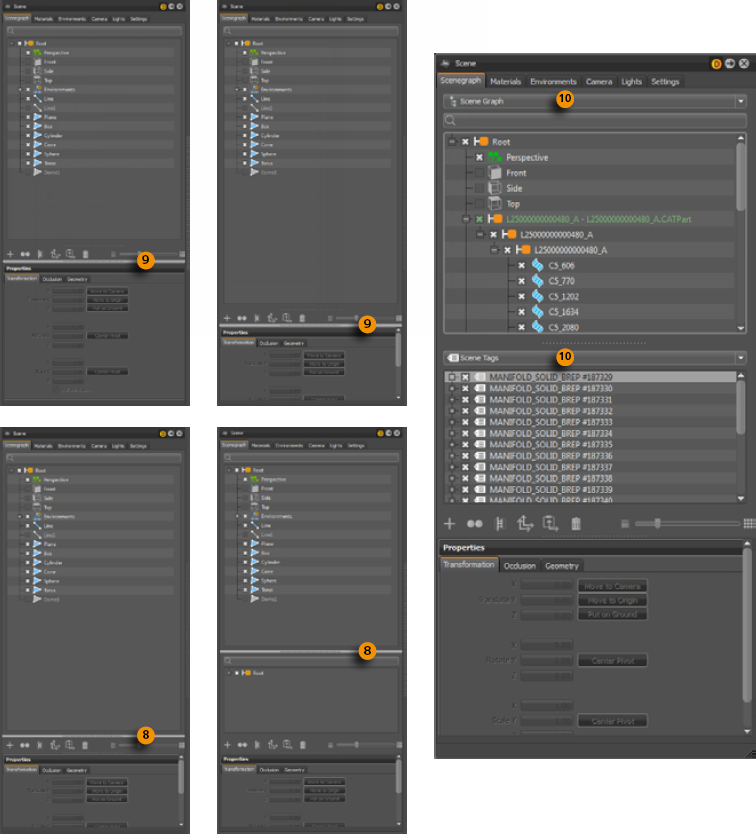

If NURBS data within the scene there is the possibility to show/edit scene tags. Above the middle window and above the search field a drop-down field (10) appears to chose which window should show tags and/ or scene tree.

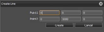

A line is the connection of two points. Every point has X, Y, and Z coordinates for it's positioning in 3D space. The representation of a line object in render view depends on the active render engine. This means that in OpenGL mode a line is represented as a line, but in Raytracing mode it is represented as a tube capped with half spheres on both ends. The radius of the representation in that case is controlled by the material setting Line Tube Radius, accessible within the standard UI.

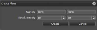

A plane is a flat quadratic face often used to place object shadows onto the ground below. It has X and Y dimensions and it requires input for the number of sub-divisions for both axes.

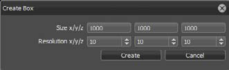

A box describes a quadratic, 3D room also known as cube. It has X, Y, and Z dimensions and it requires input for the number of sub-divisions for all axes.

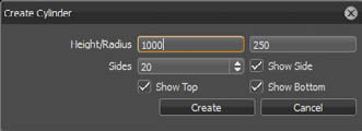

A cylinder is an object that has two circular ends with same radius parallel to each other. A cover wrapped around the distance between (height) builts the outer skin of the primitive. Increasing the number of sides makes the object look less faceted. Faces for top, bottom or side are only created when related checkboxes are selected on creation.

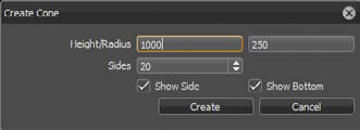

A cone is similar to a cylinder. It has also a circular base at the bottom but its top end is a single point instead of a circular face. Faces for bottom or side are only created when related checkboxes are selected on creation.

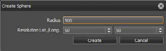

Sphere is the distinguishing name for a 3D primitive in the form of a ball. Every point on the surface has the same distance to the center point. This distance is adjusted within the dialog box by the radius value. The values for latitude and longitude resolution results in amount of horizontal and vertical sub-divisions.

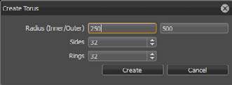

A torus is an object that's shape equals a donut. A section cut would show a circular profile limited by the inner and outer radius. Imagine on creation that the profile is rotated around the perpendicular axis in the center of the object. The value for rings controls the number of subdivisions along that rotation, sides controls the number of horizontal sub-divisions.

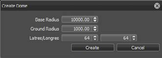

A dome has a flat circular surface at the bottom and a half sphere on the top, also known as hemisphere. The border edge to the bottom surface is chamfered. The Base Radius value on creation dialog box controls the dimension of the half sphere, Ground Radius controls chamfer creation. Setting for Latres results in number of perpendicularly sub-divisions, Longres controls number of sub-divisions around the perpendicular axis.

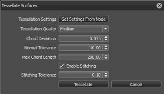

VRED's trueNURBS concept provides the usage of CAD NURBS data directly within the scene. Features for editing geometrical properties of NURBS objects or their polygonal representation are available here.
CAD generated construction data is mathematically precise; exact defined by a technique called Bézier curves. VRED's directNURBS Raytracing mode is able to represent NURBS data without any preparation.
OpenGL mode requires generating a polygonal representation before. This process is called tessellation. It enables changing the complexity/amount of polygons of an object at anytime. NURBS data coexists besides polygonal data (same node object within scenegraph); this enables re-tesselation without reloading the files before.
A polygonal representation is never as precise as the source NURBS data. The higher the precision the more polygons are generated.
| Coarse | Low | Medium | High | |
Chord deviation |
1.00 |
0.15 |
0.075 |
0.037 |
Normal tolerance |
30.00 |
20.00 |
10.00 |
7.5 |
Max chord length |
400.00 |
300.00 |
200.00 |
100.0 |
Enable stitching |
yes |
yes |
yes |
yes |
Stitching tolerance |
0.10 |
0.10 |
0.10 |
0.1 |
Combines selected NURBS components to one contiguous NURBS shell. The discontiguous condition is furthermore accessible at anytime through the standard UI of VRED.
Deletes the NURBS information that is stored beside the tessellated object. Due to this, memory consumption of the scene is reduced but re-tesselation of that object is not possible anymore.
Undo for this action is not available.

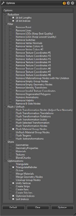

Opens the module that provides further operations for example, geometrical optimizations, sharing, and so on. Default activates a recommended selection that could increase render performance; Clear unselects all selected modules; Optimize executes selected optimization commands. All operations are applied recursively. Multiselection is supported on execution. Undo for all these types of actions is not available.
Remove B-Side Nodes: B-Sides definition is comparable with no show feature from CAD software. Execution removes shapes and components that have been set as a B-Side.

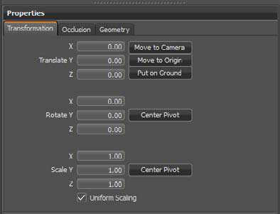

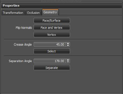

Object properties like position, precalculated shadows, and normal settings (affects shading within OpenGL render view) are available at tabs on the bottom of the scenegraph module.
A transformation contains information about the position and the orientation of an object within 3D space. It provides also information about the position and orientation of the objects coordination system.
Moves selection depending on threshold and unit setting (mm, cm, m). Move to Camera moves the selection to the same position in 3D space where the camera is located; Move to Origin moves the selection to the position of its pivot point; Put on Ground makes selection move to environment floor height.
Rotates selection in on related axis about threshold in degrees. The Center Pivot button on the right moves objects local rotation axis to the center of its bounding box.
Scales selection on related axis depending on threshold and unit setting. Enabling checkbox for Uniform Scaling restricts execution to set new value also on other related axes. The Center Pivot button on the right moves objects local scale pivot to the center of its bounding box.

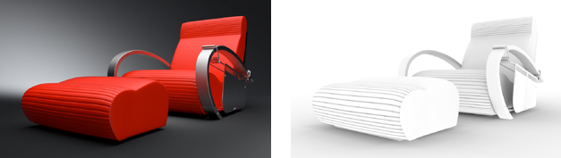

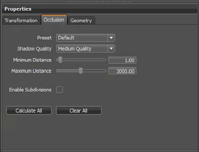

Ambient occlusion calculation - is also known as soft global illumination. It generates shadows on gaps and corners; this makes scene illustration become more realistic within OpenGL render mode.
The scene is illuminated on calculation by the HDR file from the environment node; it works without any other light source within the scene. All objects that are hidden in the moment of calculation are darkened.
The Ambient Occlusion calculation is a preprocess and takes place during data preparation. Calculated Ambient Occlusion results are baked on the geometry's vertices - stored within texture coordinates #7 and #8.
The smoothness of the calculated shadow depends on the polygon mesh resolution. Therefore VRED offers several ways to increase the quality on low quality models, like subdividing, and predefined quality presets.
Presets are containing all shadow calculation-related settings within one setting. The drop-down menu provides quick access to all available calculation presets that were saved from the Ambient Occlusion module within standard UI.
Ambient Occlusion is a specific not-physically-accurate rendering trick. It basically samples a hemisphere around each point on the face, sees what proportion of a hemisphere is occluded by other geometry and shades the pixel accordingly.
Defines the minimum distance (mm) between objects that to should be taken into account for the calculation of Ambient Occlusion shadows. This value defines total black areas where full occlusion takes place.
Defines the maximum distance (mm) between objects that to should be taken into account for the calculation of Ambient Occlusion shadows. This value defines areas where no occlusion takes place.
Subdivides existing polygon mesh into smaller triangles. This option should be turned on to avoid ragged edges on shadow illustration. This feature is helpful when NURBS data for re-tesselation is not available but a refined mesh is required. Subdividing generates more complex objects - it should only be used when required. Subdivide Geometry (edit menu from context menu of scenegraph) provides more settings to control this process.
Important: Only shadows for selected objects are calculated on execution. All visible objects in the scene are taken into account on calculation!
The Geometry editor from simple UI contains commands to turn polygon normals, vertex normals, and operations that affect the shaded illustration of the object within the OpenGL render mode.
Polygons got a font-face and a back-face; the face normal is located centered and in right angle to the font-face. For Ambient occlusion calculation it is required to have polygons turned to the right direction. Otherwise calculation provides undesirable darkening effects where normals are turned. Every polygons vertex also has a normal that affects shading. Face/Surface turns all face normals of selection into the other direction. Face and Vertex turns both kinds of normals from selection. Vertex affects only normals from polygons vertices.
Vertex/Face Normal Rendering mode available on settings tab of scene module from simple UI gives visual feedback about the orientation and it enables the adjustment of objects that contain inconsistent normals.
Threshold defines an angle that is considered on shading illustration; all object edges that got a lower angle to the face beside are drawn smooth. Object edges with a higher angle than threshold display faceted. A value of 45 degrees let objects appear smooth.
Defines the angle between the vertex normals. Needed in case of merged objects for example.

Scenegraph icons for B-Side line and polygonal shapes (active and inactive)
