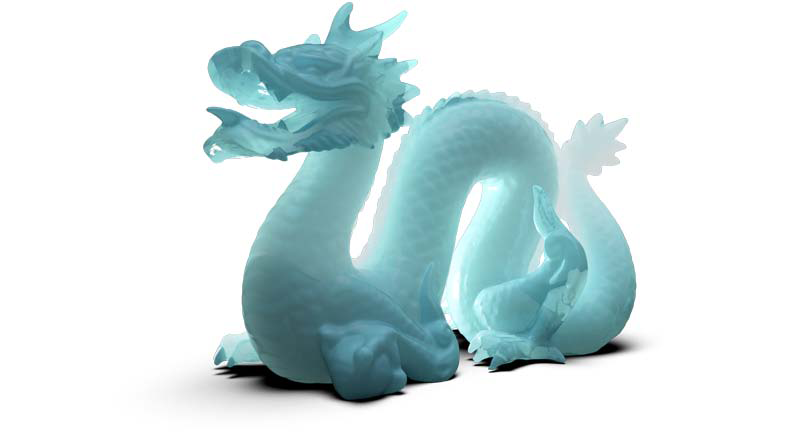

Subsurface Scattering
Translucency and subsurface scattering are two different methods for calculating light passing through the back of an object into the observer's eye. While translucency requires far less calculation power, subsurface scattering offers more possibilities and greater flexibility.
Scattering Mode Translucency
There are two modes when operating with translucency, depending on what objects to project:
  • Thin Walled Translucency: Suitable for one-sided objects. It requires more calculation time than the solid translucency mode, but when in doubt, use this mode.
  • Solid Translucency: Used for solid objects only. Otherwise unpredictable problems can occur when this mode is used on one-sided objects.
Color
Determines the color of the scattering/translucent light.
Roughness
Defines the amount of diffusion that is applied to translucent light.
Scattering Mode Subsurface Scattering
Incoming light on the averted side of an object is refracted in all directions. With this mode, it is possible to simulate the behavior of wax or other translucent materials. There are two modes available:
  • Single Scattering: Allows light to bounce once inside a material before it is reflected to the outside. This mode is less accurate but requires less calculation time than multiple scattering.
  • Multiple Scattering: Allows light to bounce several times inside a material before it is reflected to the outside. This mode is more accurate but requires more calculation time than single scattering.
Attenuation
The distance that the light travels inside the medium is depending on the attenuation value. The higher the value, the more light is absorbed inside the medium.
Asymmetry
AThis value describes the directional characteristic of incoming light, and its weighted behavior. The value -1 defines that light is distributed to the averted side along the incoming light path. The value 1 defines that light is distributed along the incoming light path. The value 0 describes a homogeneous distribution of light inside the medium.
Select Medium
Offers a large selection of refraction indices based on materials existing in reality. The selected medium affects the index of Refraction automatically.
Index of Refraction
The refraction index defines the optical density, and therefore the way light is refracted when passing differently dense materials.
The Texture, Repeat, Offset, Rotate, and Anisotropy settings are described in the General Truelight Material Settings - Incandescence section.

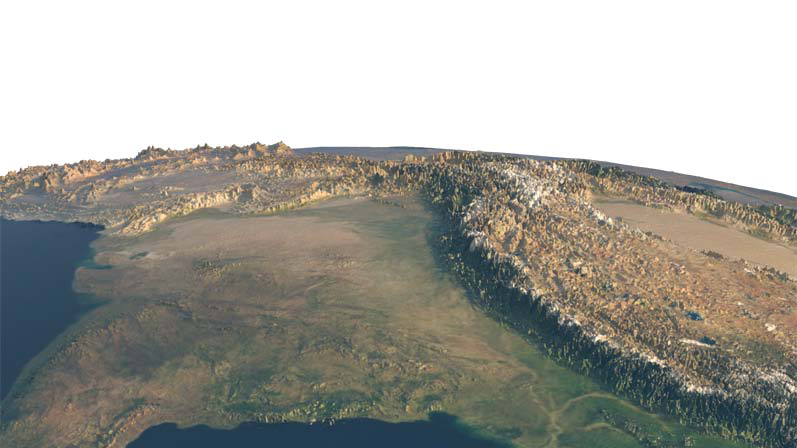

Displacement
Displacement maps are detailed maps, which are interpreted as height information. Using displacement maps you can create highly detailed structures from rather simple geometry by just using a plain image. Each point on the geometry is displaced along the interpolated vertex normals using the height information of the map, resulting in a realistic silhouette, producing correct shadows, and reflections. Accuracy is limited by the resolution of the texture image and memory requirements are low. To avoid cracks in the displaced surfaces the vertex normals should be smooth and consistent. Using a higher tessellated bases mesh can improve performance a lot.
Displacement Height
Defines the height of the displacement.
Use Accurate Silhouettes in OpenGL
This feature allows you to calculate the displacement in OpenGL like in raytracing mode. Selecting it may drastically reduce the performance.
