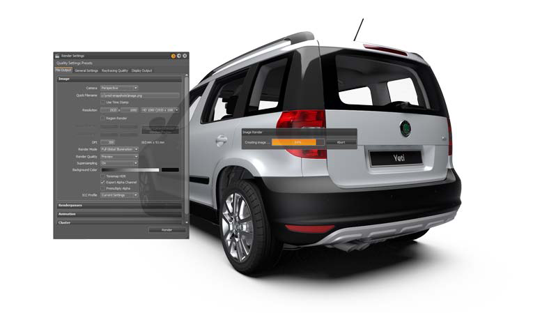

The render module makes all usual settings to create images or movies available. It is accessible from the quick access bar or by the related entry from the Rendering menu.
Quality Settings Presets
Click Quality Settings Presets to display a context menu that allows saving, loading, and deleting all settings entered in that module.
File Output (tab)
View
Select the view to be used for image calculation. All viewpoints, predefined camera track animations, or variants (if camera was active on its creation) can be selected from the drop-down menu. If a track is chosen, all contained viewpoints are rendered automatically.
Filename
Sets the path and name of the image file to save the rendering to.

Render Mode
Sets the illumination mode to apply for rendering the image to a file.
The following render modes are available:
  • CPU Rasterization: This mode does not compute direct reflection, nor does it compute refraction or any other sophisticated visual effect.
  • Precomputed Illumination: This mode is comparable to VRED OpenGL rendering mode. It uses precomputed Ambient Occlusion and indirect illumination for rendering and calculates specular reflections and refractions and correct shadows from light sources.
  • Precomputed + Shadows: This mode uses precomputed image-based lighting and indirect illumination but doesn’t use precomputed Ambient Occlusion values. Instead, it calculates shadows based on the active environment.
  • Precomputed + IBL: This mode uses precomputed indirect illumination and samples the environment.
  • Full Global Illumination: The Full Global Illumination Mode doesn’t use any precomputed values but accurately samples everything in a physically based approach. Other features like Photon Mapping require the render mode to be set to Full Global Illumination.
    Caution: This value automatically changes the still frame illumination mode on the Raytracing Quality tab.
