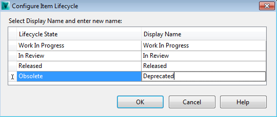

  1. Select Tools Administration.
  2. Select the Items tab.
  3. In the Lifecycles and Revisions section, click Configure.
  4. In the Configure Item Lifecycle dialog box, select a lifecycle state from the list.
  5. In the Display Name column, double-click the current display name for the lifecycle state and then enter a new display name.
  6. Click OK.
