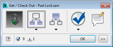

Learn about the Get/Check Out dialog in the Vault Client.
The Get/Check Out dialog has two view settings: collapsed and expanded.
Collapsed View |
Expanded View |
![]() The collapsed view provides an express workflow for checking files and folders out of a vault. |
![]() The expanded view provides more information about the files available for check out. Additional settings are also available in this view, such as working folder preferences or released bias enforcement. |

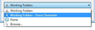

Working Folders Drop-Down Menu
Specify whether you want to use the default working folder or select another folder to store the local copies of the objects that you download. You can also select no working folder.
Note: See Manage the Working Folder for more information.
