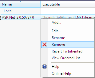

  4. Double-click ISAPI Filter .
  5. Right click the filter which is causing the error and select Remove.

  5. Double-click ISAPI Filter .
  6. Right click the filter which is causing the error and select Remove.
