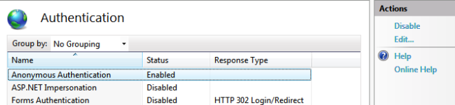

- Double-click Authentication.
- Click Anonymous Authentication and make sure it is enabled.
- Right-click on Authentication and select Edit to display the user name of the anonymous account used by IIS. Verify that this account exists on the server.
- Click Edit to display the user name of the anonymous account used by IIS. Verify that this account exists on the server.
