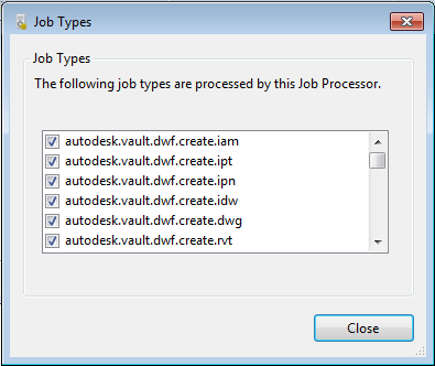

View Job Types with the Job Processor
You can view the types of jobs that the Job Processor handles by accessing the Job Types dialog.
Access the Job Types Dialog
  1. On the workstation where you want jobs to be processed, select Start > All Programs > Autodesk > Autodesk Data Management > Tools > Autodesk Job Processor for Vault [edition]] to launch the Job Processor application.
  2. Select Administration > Job Types to display the Job Types dialog. If the workstation does not have the necessary information to process a particular type of job, that type of file is unchecked.
The job types a workstation can process are indicated by a check next to the type in the Job Types dialog.
