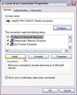

  1. Launch the Windows Control Panel.
  2. In the Control Panel, double-click Network Connections.
  3. Right-click Local Area Connection and then select Properties.
  4. In the Local Area Connection Properties dialog box, click Install.
  5. In the Select Network Component Type, select Service and then click Add.
  6. In the Select Network Service dialog box, select File and Printer Sharing for Microsoft Networks.
  7. Click OK.
