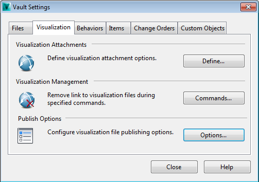

Configure visualization attachments, manage visualization files, and configure publishing settings on the Visualization tab of the Vault Settings dialog.
Access the Visualization Tab on the Vault Settings Dialog
Administration
Vault Settings. Visualization Attachments
You can enable or disable file attachments, specify where visualization attachments are published, and disable or enable the DWF warnings by clicking Define in the Visualization Attachments section.
Visualization Management
The Visualization Management options allow you to specify which commands break the link between a data file in the vault and its corresponding visualization file.
Publish Options
