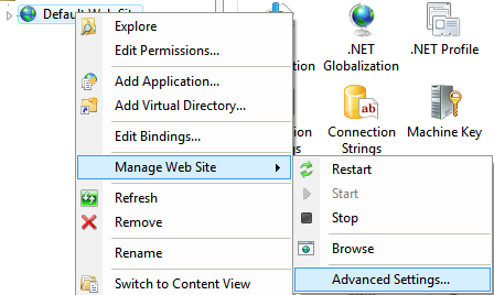

  3. In the Internet Information Services dialog box, expand local computer ► Sites and click on Default Website.
  4. In the Manage Website section, click Advanced Settings.

  1. Open Administrative Tools and select Internet Information Services Manager.
  2. In the Internet Information Services dialog box, expand local computer ► Sites and click on Default Website.
  3. In the Manage Website section, click Advanced Settings.
  4. On the Advanced Settings dialog, expand Connection Limits.
  5. Change the Time-out value to 900, and click OK.

  4. In the Internet Information Services dialog box, expand local computer ► Sites and right click Default Website and select Edit Bindings > Manage Web Site > Advance Settings.
  5. Expand Connection Limits, change the Time-out value to 900, and click OK.
