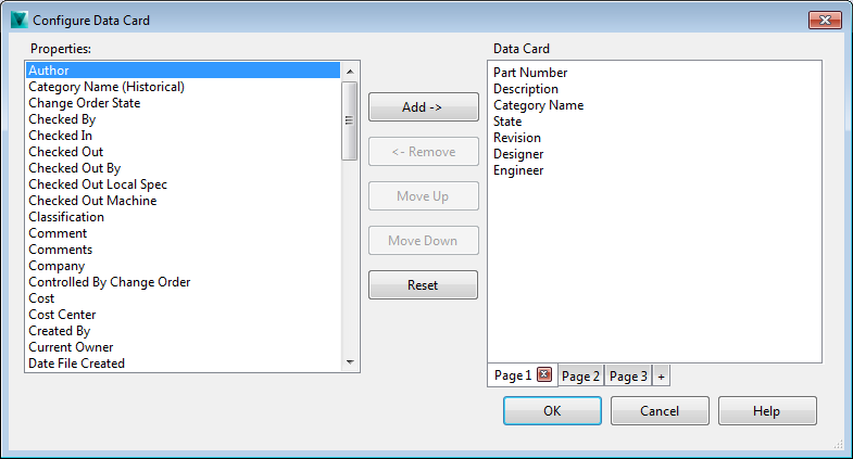

Administrators can configure the data card layout on the Configure Data Card dialog in the Vault Settings dialog. Here they can determine how many pages a data card uses and which properties are displayed for modification. With the versatility to add and remove properties for editing, the administrator can streamline property management.
Select Tools  Administration   Vault Settings  Behaviors tab and then click the Data Cards button to access the Configure Data Card dialog.
Configuring Data Card Layout
Manage tabs and determine which properties are available for the CAD user to modify on the Configure Data Card dialog. A properties list displays all of the properties that can be added to the selected tab. A property can be added to a single tab only once. Several different tabs, however, can list the same property.

Configure Data Card Layout
  1. Select Tools  Administration  Vault Settings  Behaviors tab Data Cards button.
  2. On the Configure Data Card dialog, select one or more properties from the properties list and click Add to add them to the selected tab.
    Select a property and click Remove at any time to refine the properties on the selected tabs.
  3. If necessary, click the Move Up or Move Down buttons to reorganize the properties on the tab as you prefer.
  4. Double-click the selected tab and rename it.
  5. Click the + tab to create a new tab.
  6. When finished, click OK to save your settings and close the dialog.
  7. Click Reset at anytime to restore the dialog to the last save layout.
