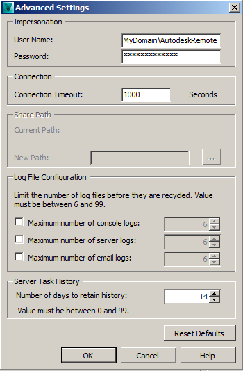

Set the new account in the Autodesk Vault Server Console
  1. On the Vault Server machine, open the Autodesk Vault Server console.
  2. Select Tools > Administration.
  3. On the Advanced Settings tab, select the Settings button next to Advanced Configuration settings.
  4. In the Advanced Settings dialog box, change the User Name to MyDomain\AutodeskRemote, and enter the corresponding password.
  5. Apply the changes and then click OK.
