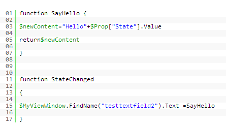

The event is caught and the function StateChanged is called. The property "State" is bound to a textfield (testtextfield). Now each time the user inserts some new text in this field, the function StateChanged is called. Another simple function (SayHello) can be used to write a result ("Hello"+ string entered) in another field (testtextfield2). These two functions can be written like this:
The xaml file has two text-fields with the name "testtextfield" and "testtextfield2". The first one is bound by a property called "State".
Now when you start Data Standard and write something in the "testtextfield", Data Standard shows as hello+ the text that you wrote. This is just a simple example but it hopefully provides some ideas for adding new features to the Data Standard dialog or helps you address any problems.
