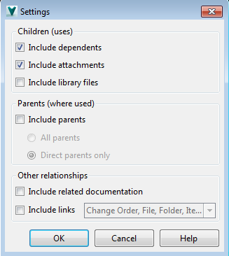

Example of the Relationship Settings for Check In
Relationship Options
Specify whether only the children of the file, the parents of the file, or all related files are included in the vault operation. Vault Professional users can also decide whether to include linked objects.
- Select the Include dependents check box to apply the vault operation to all files on which the selected file depends.
- Select the Include attachments check box to apply the vault operation to all files attached to the selected file.
- Select the Include library files check box to include any parent/children files in the library folders. The Include dependents or Include attachments check box must be enabled for this parameter to work.
- Select the Include Parents check box to apply the vault operation to all files that depend on the selected file. Turn on Direct Parents Only to include only the files that depend on the selected file within one level.
- Select the Include related documentation check box to apply the vault operation to specially designated files, such as IPN and IDW files. When used in conjunction with the Include dependents or Include Parents check boxes, the vault operation will apply to files related to the dependent or parent files as well, respectively.
- Select the Include Links option to include linked files or files associated with a linked object in the check in. Select which types of linked objects you want to include from the Include links drop-down.
The data associated with the linked objects are not included in the selection set. Refer to Project Links for more information.
