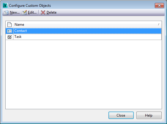

Access the Configure Custom Objects Dialog
Create, edit, and delete custom object definitions.
Note: You must be an administrator to create or modify custom object definitions.
Access
  1. Click Tools > Administration > Vault Settings.
  2. In the Vault Settings dialog box, select the Custom Objects tab.
  3. Click Configure to open the Configure Custom Objects dialog.
