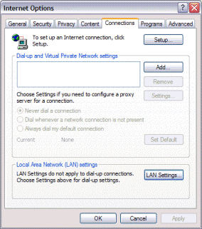

Change the Proxy Settings in Internet Explorer 6.x and 7.x
  1. From the Tools menu in Internet Explorer, select Internet Options.
  2. In the Internet Options dialog box, click the Connections tab.
  3. Click LAN Settings.
  4. If the "Use a proxy server for your LAN" check box is enabled, turn on the Bypass proxy server for local addresses check box.
  5. Click OK.
  6. Click OK to close Internet Options.
  7. Note: By bypassing the proxy server for local addresses, all addresses without a period (for example: http:// webserver) will bypass the proxy and be resolved directly.
