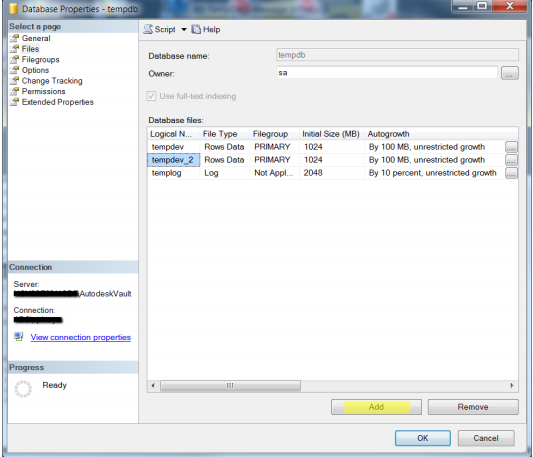

  5. If using a multi-core system, additional data files should be configured, using the guidelines below. If using a single-core system, skip to step d below.
    1. Data file totals should equal half of the available physical processing cores - up to a maximum of 8 data files. (example; 8 physical cores would equal 4 total data files, tempdev, tempdev_2, tempdev_3, tempdev_4)
    2. Click the Add button to add additional data files.
    3. Name the new file(s) tempdev_2, tempdev_3, … as needed.
    4. Set initial size of each data file to 1,024 MB. If using a total of 8 datafiles, an initial size of 512 MB can be used.
    5. Set Autogrowth to 100 MB, unrestricted growth for each data file.
    6. Set the LDF log file to combined data file total. (example; if there are 2 data files total, the resulting LDF should be set to an initial size of 2048 MB)
    7. The results will appear similar the image below.

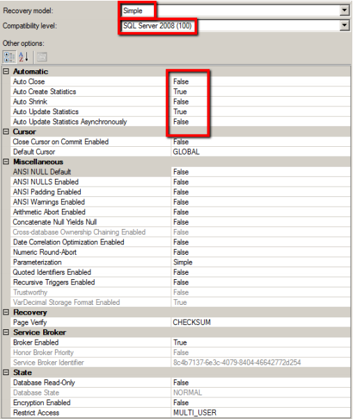

  6. Under the Options page, set the Recovery model to Simple and the Compatibility level to SQL Server 2008 (100).
  7. Select OK.

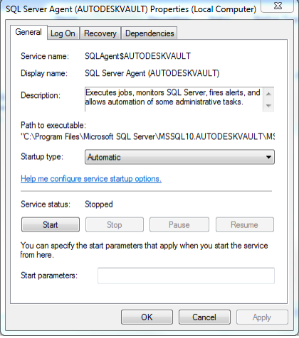

  3. From the Control Panel, double-click Administrative Tools and then double-click the Services icon.
  4. Locate the SQL Server Agent (AUTODESKVAULT) service
  5. Right-click on the SQL Server Agent (AUTODESKVAULT) and select Properties.
  6. . Change the Startup Type to Automatic and start the service.

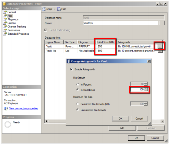

  7. Open the Microsoft SQL Management Studio and connect to the AutodeskVault instance. Use <ComputerName>\AUTODESKVAULT as the server name and press Connect.
  8. Right-click on the Vault database and select properties.
  9. On the Files page set:-
    • the Autogrowth value for all <Vault> databases to by 100MB, unrestricted growth
    • the Initial Size value of all <Vault>_log files to 500MB
    • the Autogrowth value for an <Custom_Library> files to 25MB
    • the Autogrowth values for all _log files to By 10 percent, unrestricted growth

  10. On the Options page, change the Recovery Model to Simple, Compatibility Level to SQL Server 2008 (100) and change the Auto Shrink drop-down list to False. All values under the Automatic heading should be set as shown below.
  11. Perform these same steps for all of the KnowledgeVaultMaster, Vault, and Library Vault databases (steps 8 – 10).
