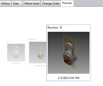

Preview a File
You can preview a file before you open it for editing by choosing a file and selecting the Preview tab in the Preview pane.
The preview style defaults to a carousel view of thumbnails, allowing you to cycle through historical versions of the file in Vault Basic and historical revisions of the file in Vault Workgroup and Vault Professional. The file version or revision is displayed at the top of each thumbnail, and the last check-in date is displayed at the bottom.
