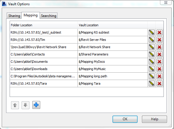

Map any local, network, or Revit server folder to any Vault folder on the Mapping tab of the Vault Options dialog.
Note: You must be an administrator to modify mapping options.
Create a New Mapping
  1. Click Options on the Vault Ribbon tab to launch the Vault Options dialog.
  2. Selecting the Mapping tab.
  3. Click Add to launch the Create Mapping wizard.
  4. Select whether you want to map a local folder or Revit Server folder to a folder in Vault.
  5. Enter the path for the folder or click the ellipses to browse for the folder location.

  8. On the Select the Vault folder screen of the Create Mapping wizard, enter the path or click the ellipses (...) to browse to the Vault folder to which you will map your file system or Revit Server folder.
  9. Click next to validate the mapping.
    If the mapping is valid, a confirmation displays showing the new mapping configuration.
    If the mapping is not valid, an error message displays and the wizard displays the attempted settings. An error may occur if one or both of the folders being mapped are already part of an existing mapping configuration. Modify your mapping settings and click Next to validate the changes.
  10. Click Finish to close the wizard.
  11. Click OK on the Vault Options dialog to save your mapping changes.
    Important: If you do not click OK on the Vault Options dialog, your mapping changes are not saved.

    Mappings are listed in order of priority.
  3. Select one or more mappings and use the Move arrows to arrange the mapping in the preferred order.
  4. Click OK on the Vault Options dialog to save your mapping changes.
