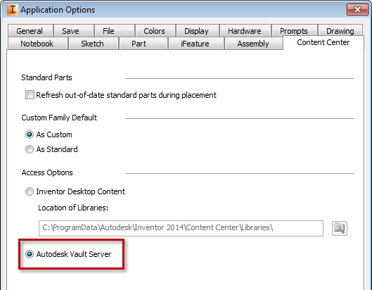

  1. Inside the Inventor Application Options dialog, make sure that Inventor is configured to use Vault for Content Center Libraries.

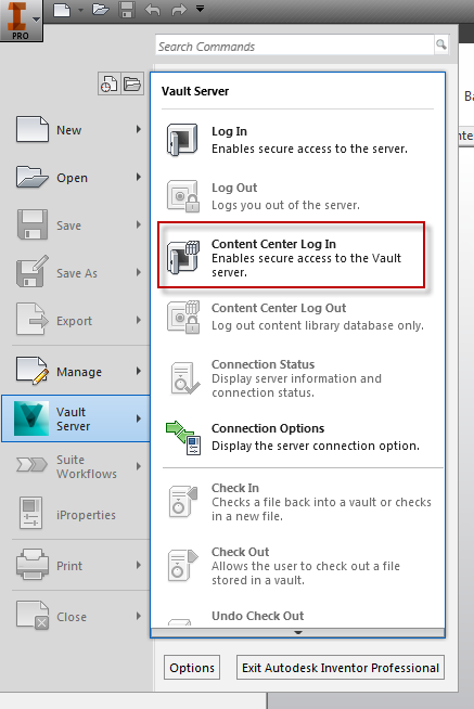

  2. In the Inventor Application menu, select Content Center Log In.

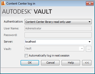

  3. On the Content Center Log in dialog set the server for the Content Center Libraries.

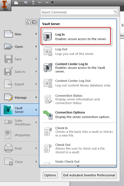

  4. Go to  Application Menu ► Vault Server ► Log In.
  5. Log into Vault.
