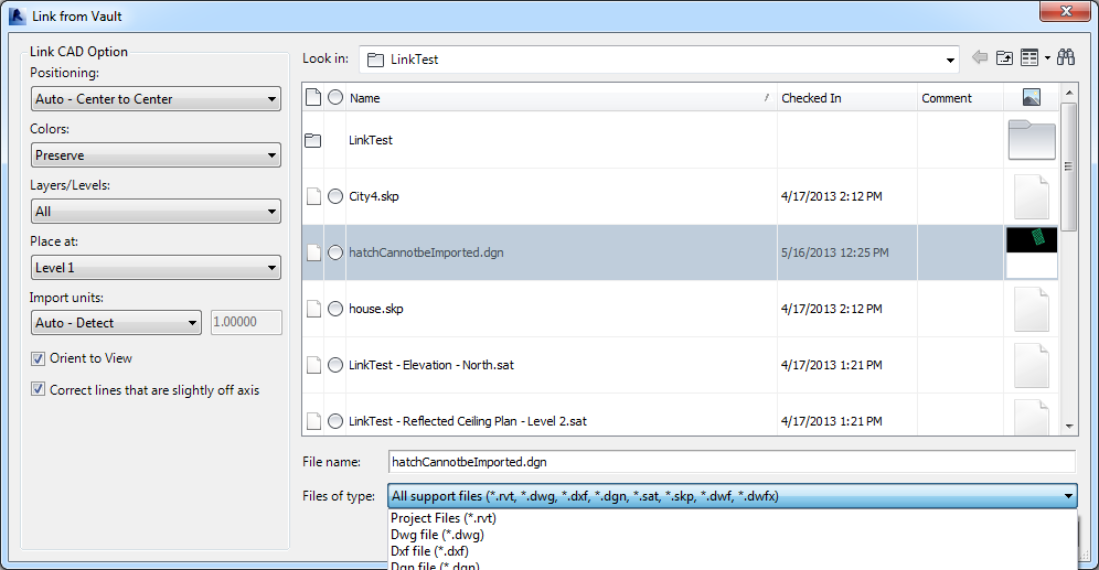

The Link from Vault Dialog
You can select a file in Vault to be linked to the current Revit project and specify position options for the linked file on the Link from Vault dialog.

Position Options
    You can select a positioning preference when you link a file into the current Revit project.
    The following table describes the positioning options available for selection. Refer to Import and Link Options for CAD Formats and Revit Models for more information.
