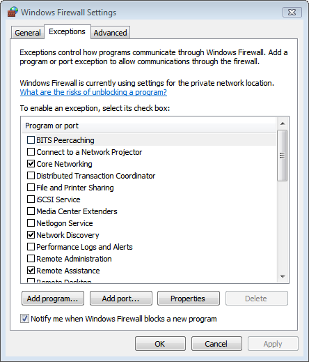

Windows Server 2008 Firewall Settings
  1. From the Windows Control Panel click Security.
  2. Below Windows Firewall click Allow a program through Windows Firewall.
  3. Click the Exceptions tab.
  4. On the Exceptions tab, verify that the default web port is listed in the programs and services not blocked by the firewall. If it is not listed, click Add Port.
  5. In the Add a Port dialog box, enter "Vault" in the Name field and specify 80 as the port number.
  6. Check the TCP option.
  7. Click OK.
If you are using SSL with Autodesk Vault server, make sure that port 443 is also on the list of programs and services not being blocked. If it isn't, repeat the steps for port 443.
