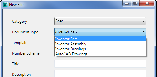

The default New File dialog for Data Standard contains a combo box called Document Type.
When a user selects an option from the Document type list and clicks OK, the New Data Standard File function looks for a template in the Vault folder path associated with that document type. The template is used to generate the new file.

The element <Name> defines the value that is displayed in the combo box on the New File dialog. The element <TemplatePath> is invisible to the user, but is used to set the "TemplatePath" inside the View Model.
The combo box "Document Type" looks like this:

The attribute DisplayMemberPath defines which element from the data source is used for display in the combo box. In this instance, it is set to "Name."
The attribute SelectedValuePath defines which element from the data source ("TemplatePath") is set as the template path value to use.
The attribute SelectedValue="{Binding TemplatePath}" sets the selected template path in the View Model. The new binding property "TemplatePath" has to be added to the View Model.
