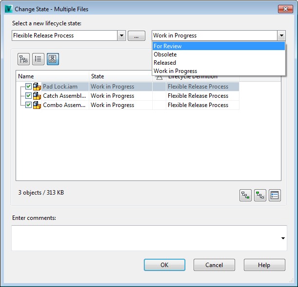

Learn About the Lifecycle Definition Filter and Batch Change State Updates
The lifecycle definition filter drop-down contains all of the lifecycle definitions that exist for the project data listed within the relationship grid. This filter is used in conjunction with the lifecycle state drop-down. The two fields are used to update all data within a given lifecycle definition to a new lifecycle state. If the user wants to change all of the project data in a given lifecycle definition to a new lifecycle state, here's the workflow:
  1. In the lifecycle definition filter drop-down, choose the lifecycle definition for which you want to do a batch update.
  2. In the lifecycle state drop-down, select the new state for the files assigned to that lifecycle definition. This action changes only the lifecycle state of files with the lifecycle definition specified in the lifecycle definition filter drop-down.
For example, if you want to change all files in the grid that are in the Basic Release Process to the Work in Progress state, choose Basic Release Process in the Lifecycle Definition Filter drop-down. At this point, no changes have been made to states within the grid. Next, choose Work in Progress from the lifecycle state drop-down. All files in the grid that have the Basic Release Process are changed to the Work in Progress state.
