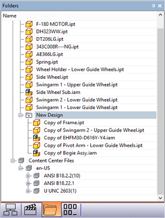

Review the source and destination folders for the copy design operation on the Folders panel.
Important: This topic is intended for Vault 2015 R2 users. Vault 2015 users should see the original
Copy Design help topics.
Note: Folders are not created in the destination list until a copy operation successfully completes.
You can also perform the following actions:
- Drag-and-drop files between folders or from the main grid onto a folder on the Folders
panel.
- Perform bulk copy actions by right-clicking on a folder and selecting an action to apply to all files in that folder.
- Rename folders.
